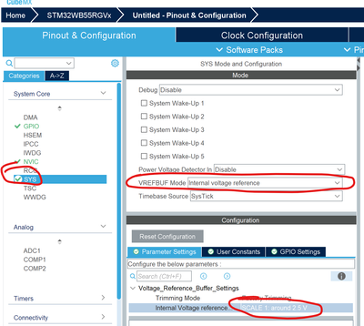

Yes, you were right. Thank you very much! Can you please tell me how to configure VREFBUF? I don't have this parameter in the cube.
2025-05-13 11:25 AM
The settings for VREFBUF are under SYS.
2025-05-13 3:25 PM - edited 2025-05-14 6:22 AM
I think I did it. Thank you very much!
