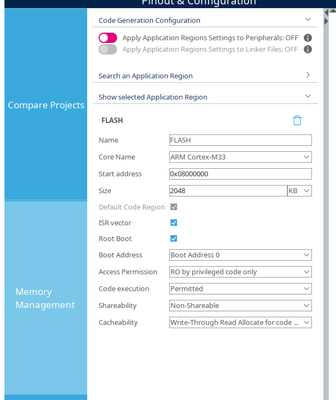

After I returned from lunch it suddenly worked. I can't say what is different now. I repeated the same steps I did the last days to run into this error. But I can't replicate it. Even attached another Nucleo board which also showed that error -> also works.
1. One thing I did is to simply set the "enable" checkbox in the FLASH section (in CubeMX). But I am unsure if that was the issue, since deactivating it still works.
2. Could you confirm that this is the correct configuration for the FLASH memory?
Thanks,

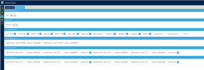

2025-05-13 4:54 AM
Thank you, could you please also send your option bytes? Do you use any memory protection?

2025-05-13 7:47 AM
The CubeProgrammer showed that no write protection is active anywhere.
Thanks,
Vincent
2025-05-14 2:41 AM
yes, the settings should be fine. Please let me know if the issue occurs again.
