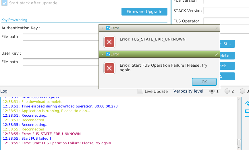

2022-05-13 3:41 AM
Dear Remy,
I've read the page, and while upgrading the FUS, it feils on step 3.1.2 Start FUS:
here is a capture of the error withint the STM32CubeProgrammer 2.10.0
(i've tried several times as specified with board reconnection)
Best regards,
