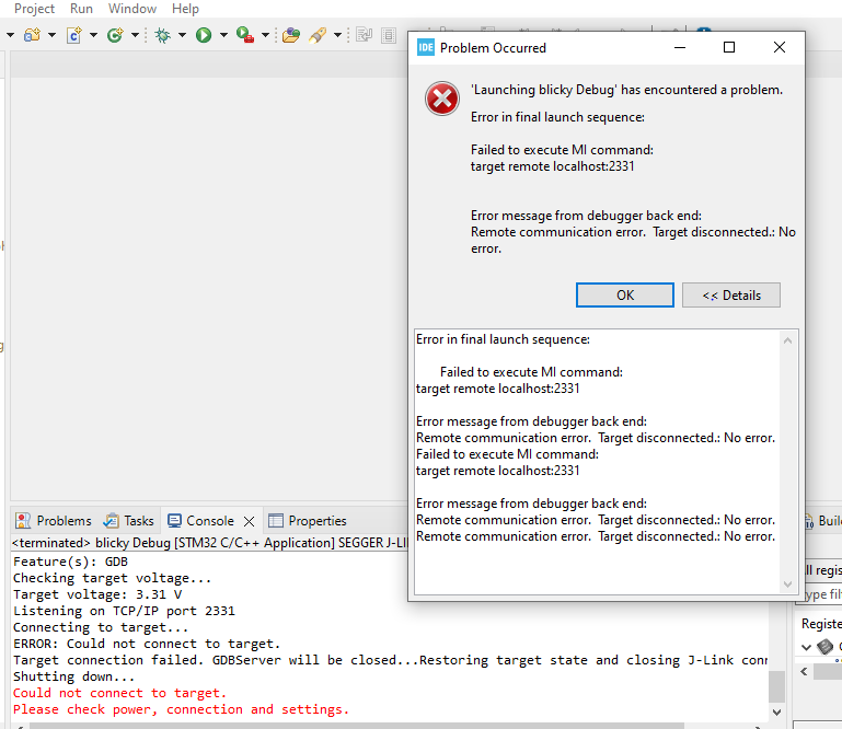

I am trying to flash basic Led blinking code. During the flashing, I have seen the error which is attached with this forum. I have double checked the connections.
Details of the board: LoRa-E5 Dev Board which has STM32WLE5JC.
Debugger: Segger Jlink
IDE: STM32CUBEIDE
Please do the needful.
Thanks
Mahesh

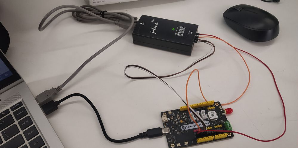

2023-02-27 3:48 AM
I have connected one end of the debugger (j-link) to PC and other end to the STM32WLE5 Development board (LoRa-E5 Dev Board). The connection looks as below. I am using J-link debugger to flash the code.

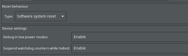

2023-02-27 5:00 AM
connected are : gnd, vcc, swd, swc, rst ?
and then setting is: con.under rest ot try software sys.res.
2023-02-27 8:07 PM
Yes, the connections are connected as gnd, vcc, swd, swd, rst from the debugger to the Dev board. Will try the software system reset and update you. Thanks

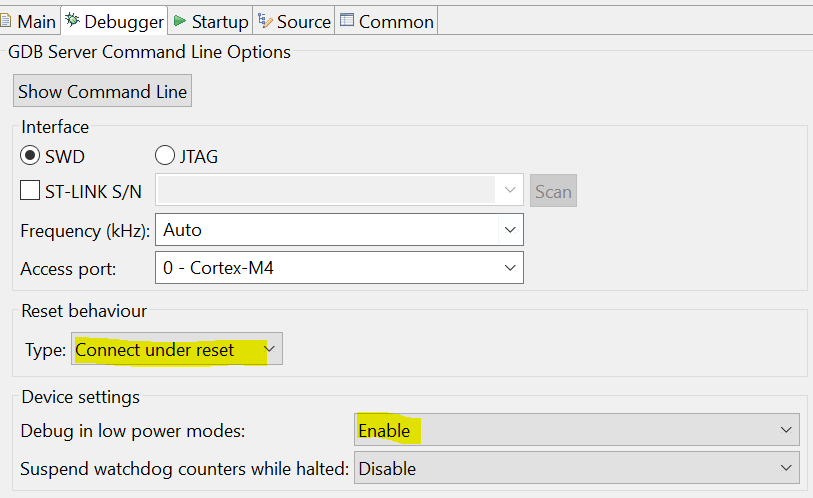

Hello @TGUDL.1 ,
1- Try to test the same scenario with Cubeprogrammer
2- I wonder you to enable low power debug mode and connect under reset as shown in the screenshot bellow:
Also, you should mass erase the flash memory using the following link that may help you to do that:
How to solve debugger connection issues (st.com)
Best regards,
Wijeden,
