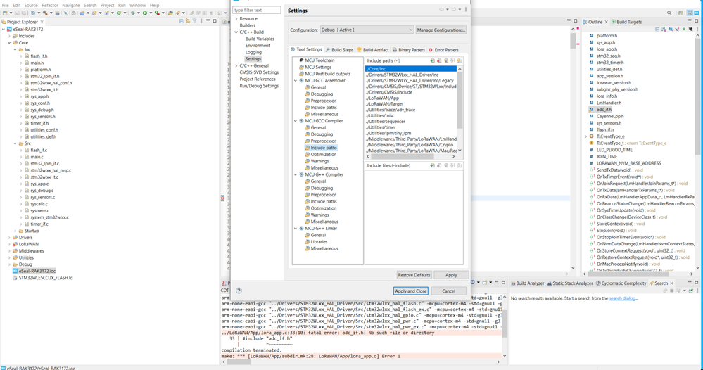

as you see i think that the path is already included ...
