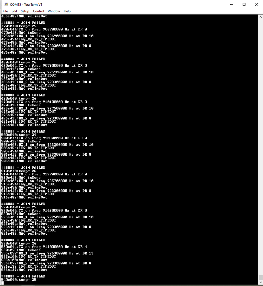

However the NUCLEO-WL55JC1 fails to join and cycles through join attempts returning "JOIN FAILED" each time due to "MAC rxTimeOut"
I've attached screenshots of TTN console and the serial output from the Nucleo board
