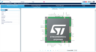

I recently updated my CubeMX version from v6.14.1 to the latest, and am no longer able to open the .ioc file. Selecting "continue", results in attempting to unzip DB.6.0.141.tar.bz2 where it hangs until failing.
Selecting "migrate" results in the following error, "Range [14, 2) out of bounds for length 2".
My team is seeing this issue on Windows and Linux.

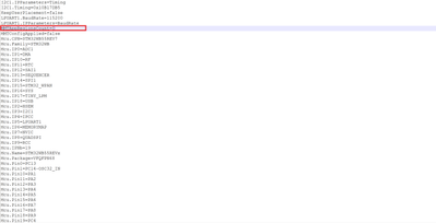

2025-09-18 3:46 PM
Hello @bryanwebb
Could you please add your .ioc file here.
Best Regards.
STTwo-32

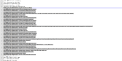

Hello @bryanwebb
Those behaviors are escalated internally for correction (under internal tickets number 217885 and 214520). For the Continue option, there is no workaround currently, but it will be solved on the future. For the Migration option, i suggest you to
Best Regards.
STTwo-32
2025-09-22 10:25 AM
Thanks, that solved the issue
