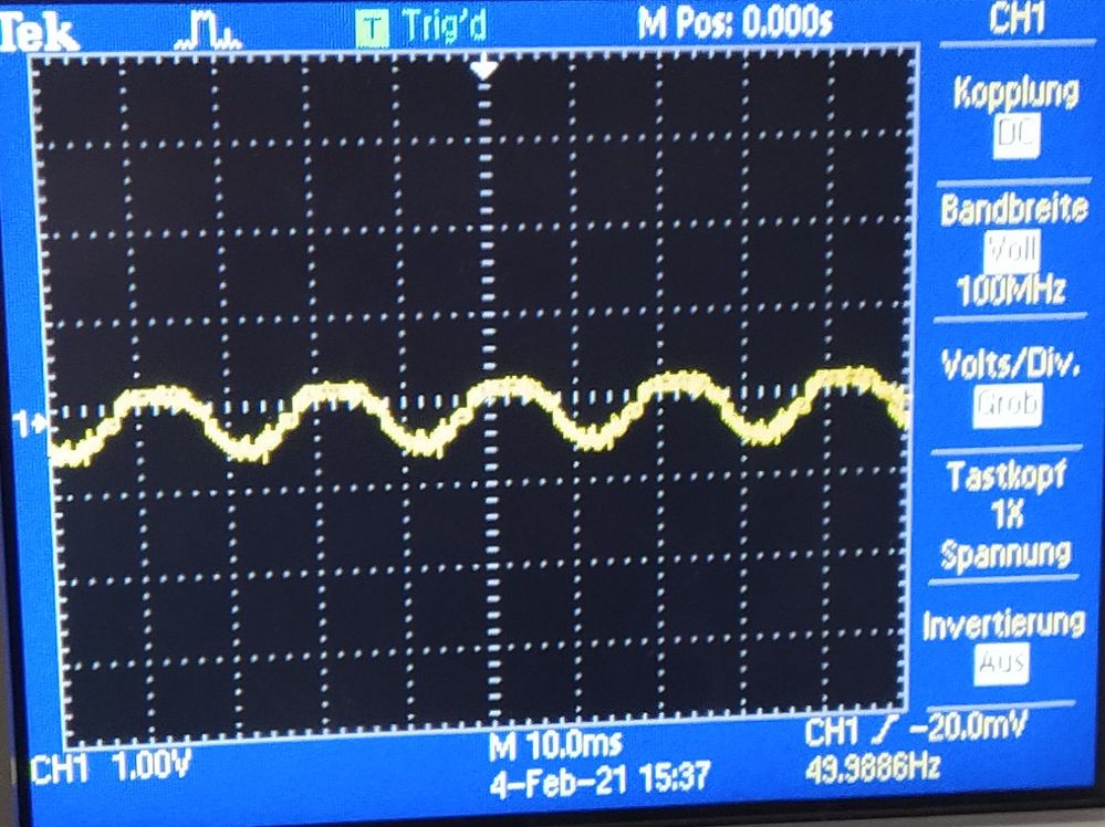

Hey guys, I'm Working on the NUCLEO-55WLJC1 Board. My Problem seems very simple but I've been struggling with this for some time now. I want to use HAL_GPIO_TogglePin To toggle a pin, but it has no effect at all. I tried to use HAL_GPIO_WritePin instead, which doesn't work either. So I meassured the Voltage of the Pin and this is how it looks like:I thought there might be something wrong with HAL_Driver, but since I'm working with the Device Configuration Tool of the STM32ide everything was initialized from the start.

Read out and check/post content of the related GPIO registers.
Check that you are measuring on the correct pin.
