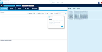

2025-08-18 10:11 PM
still not able to see the device on the st tool and not able to connect to the stmcube monitor rf.

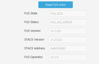

2025-08-28 1:33 AM
Hey,
I am using the stm32wb55rev6 microcontroller for my project.These are the steps i have followed till now.
I have updated the FUS firmware to the latest versions 2.1.0.0
I have uploaded the ble stack full extended version for the transparent mode and started the Wireless stack.
but after this when i burnt the transparent mode file to the stm32wb55rev6.it is going to the hard fault error.
Even i tried using the stack full firmware. In this firmware it is not going to the hardfault error but it is also not connecting to the cubemonitor rf.
I have tried every combination but no use.
Is there any other firmware i should upload after the FUS firmware?
What is the correct procedure to connect to the cubemonitor rf?
I am attaching the configuration report along with this.
Please let me know if there is any changes.
2025-08-28 2:34 AM
Hello @TejasK
Please try to migrate the transparent mode as it is on the example i've already provided. Also, check if the UART communication is working well. (the COM port is well seen on your PC).
Best Regards.
STTwo-32
2025-08-28 2:42 AM
now it is working sir.
