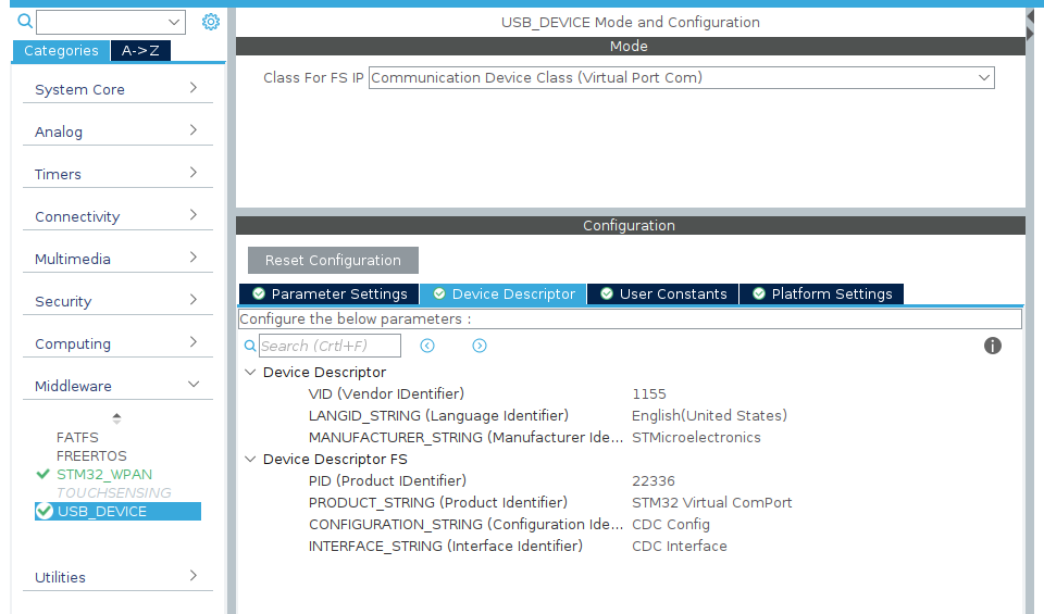

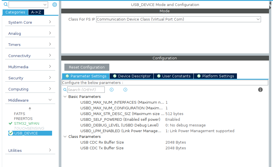

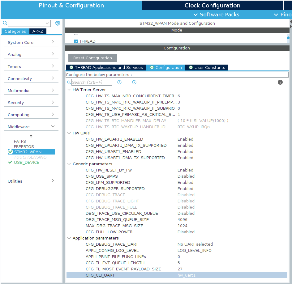

Here is my CubeMX configuration for USB and STM32_WPAN.0693W00000GZpx8QAD.png0693W00000GZpxXQAT.png0693W00000GZpxSQAT.png
