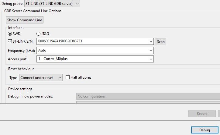

I was already using "Connect Under Reset" and i also tried the others...
