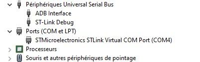

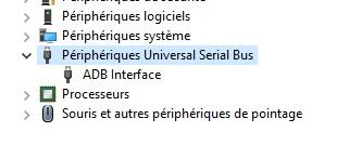

In the USB device manager I see that "ADB interface".
In the ST folder I tried to install the STLINK driver but it does not change my error.

So you did a failed upgrade?
Is the ADB Interface device the ST-LINK/V3 ?
If it's not in Device Manager as an ST-LINK not much hope of other apps "finding" it.

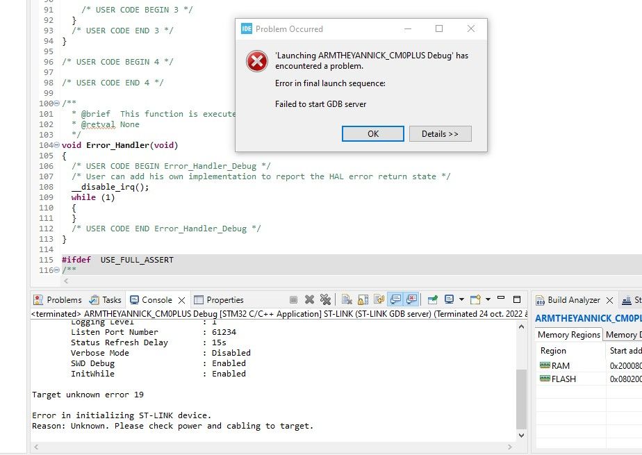

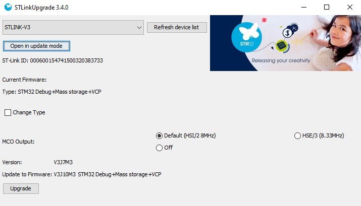

Good update : i've tried with a new cable and got this error : I've done this update before the error above :
2022-10-24 6:09 AM
Hello @BNamu.1,
Based on the screenshot you shared, an update is required again. You can click on "Upgrade" to update the ST-Link FW and solve the issue.

2022-10-24 6:10 AM
@ChahinezC
I have done this upgrade , i got this error now :

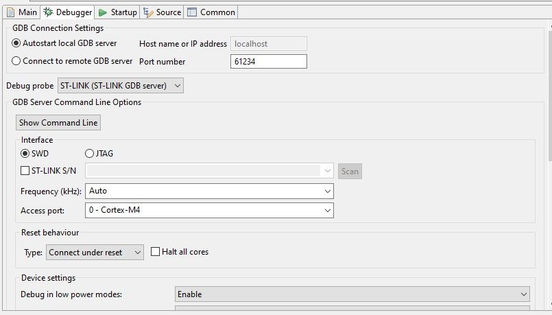

2022-10-24 9:33 AM
Check that it's actually usable in STM32 Cube Programmer, it's a stand-alone programmer.
This is complaining about chip level connectivity, might be due to low power modes, or interface circuitry being powered down.
Try other connectivity options, like "Connect Under Reset"
