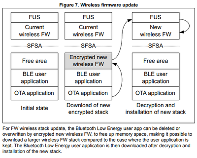

I know the AN5247 referenced there, which shows the following image
According to this it would NOT work in case of the smallest WB chips, even with the light BLE stack. Which I think of as a big drawback.

2023-09-01 1:38 AM
- The OTA application and BLE stack footprint can sometimes be reduced with optimization to free up more space.
The later is supplied by ST as an immutable binary, I dont see how I can add optimizations there. This means the bootloader would need to shrink to 8kB. Thinkable but not very likely.
- It may be possible to split the wireless stack into multiple smaller chunks that can be individually updated via OTA to fit in the remaining space.
Not really since the OTA APP needs an active copy of the stack to work.
- Using external flash/RAM for the updatable portion could work if available on the particular board/module.
Which will probably be more expensive than taking a higher capacity WB chip.
