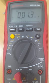

I am also not able to achieve Shutdown mode in Nucleo-WL55JC1.
Instead, I tried with STOP2 mode https://github.com/STMicroelectronics/STM32CubeWL/tree/main/Projects/NUCLEO-WL55JC/Examples/PWR/PWR_STOP2_RTC , but it also gives 2mA. Kindly let me know, How can achieve STOP2/Shutdown mode ?. Thanks in advance!

Hello @mathi_manoj ;
Could you check your measuring device?
I recommend you to follow these steps:
- Debug PWR_STOP2_RTC example
- Run the example.
- Stop run
- Remove JP1 and all jumpers on connector JP8
- Connect an amperemeter to JP1 to measure IDD current.
- Take the IDD current when the LED2 off: "system in Stop 2 mode"
Note that when the LED toggles, you are measuring the current in run mode.
On my side I tested the PWR_STOP2_RTC example and I found that the Stop 2 current consumption is 1.3µA
I recommend you to use STLINK-V3PWR for low power measurement.
Thank you.
Kaouthar
