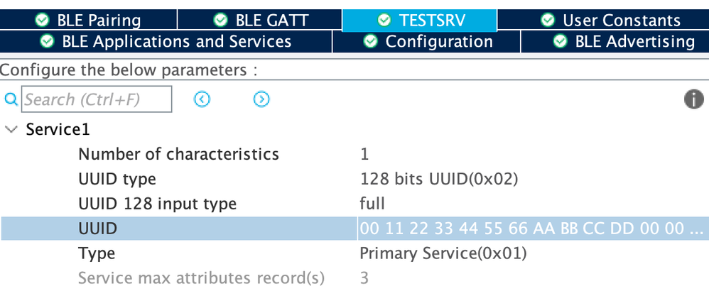

When creating a custom template BLE app in CubeMX everything works fine while not changing the UUID of service1, it builds and compiles well. But if I change the UUID to my own UUID (with UUID 128 input type to full), after generating the new code an error pops up: undefined reference to `COPY_UUID_128'
It appears the macro COPY_UUID_128 is missing now, after I add it myself in the USER CODE area, it compiles again (custom_stm.c):

@STTwo-32 I did as you asked: when I changed the UUID 128 input type from reduced to full and enter the new UUID, generate the code files, it generates in custom_stm.c the correct UUID's... but without the macro COPY_UUID_128. If I copy this macro before the change and paste it in USER CODE, it will work. If I change the UUID 128 input type again back to reduced, it will put the macro back in.
The Links to the 'old' ioc and 'new' ioc: Google Drive
Image for clarity.
