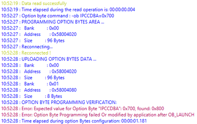

If I connect with STM32CubeProgrammer and read out the option bytes I get this:
So the option bytes couldn't be updated by the application.
If I try to do it with the STM32CubeProgrammer tool, I also get an error:

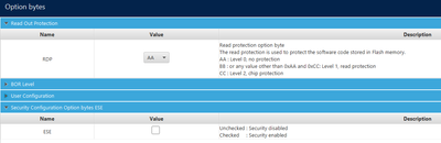

Whereas RDP level is 0 and ESE is unchecked:

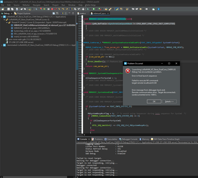

If I use the LoRaWAN AT Slave Dual core application I get stuck during:
If I try to debug CM0+ in parallel I get an error:
