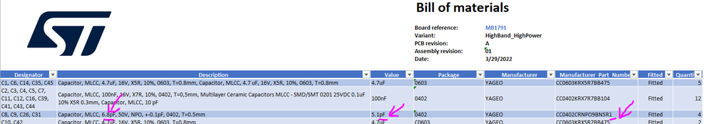

For MB1791 Development Broad, there are 3 Type of ​design:
  1. MB1791-HighBand_HighPower
  2. MB1791-HighBand_LowPower
  3. MB1791-LowBand_HighPower
0693W00000bhSADQA2.pngBut I doubt the BOM given, the part Description, Value and Manufacture Part Number are not tally for the Location: C8, C9, C26, C31:.
Pls advise the correct value for ​MB1791-HighBand_HighPower.
Thanks.

Sarra.S
Hello again @KKan.1​,
As mentioned earlier, documents will be updated soon with the right values, but I can inform you that the recommended value of C8, C9, C26, C31 is 6.8pF as it is mentioned in the board schematics:
_legacyfs_online_stmicro_images_0693W00000biE8FQAU.pngHope that helps!
KKan.1
Associate II
Hi Sara,
Thanks for feedback.
For my understanding, Schematic is general for the 3 different Band & Power reference.
BOMs is the actual that we need to follow :
  1. BOM_MB1791-HighBand_HighPower
  2. BOM_MB1791-HighBand_LowPower
  3. BOM_MB1791-LowBand_HighPower
--> STM32WL55CC - Sub-GHz Wireless Microcontrollers. Dual-core Arm Cortex-M4/M0+ @48 MHz with 256 Kbytes of Flash memory, 64 Kbytes of SRAM. LoRa, (G)FSK, (G)MSK, BPSK modulations. AES 256-bit. Multiprotocol System-on-Chip. - STMicroelectronics
Pls advise.
Sarra.S
Indeed, the BOM will be updated with the correct value 6.8pF, so you can safely use it before the update!
Hope that's clear!

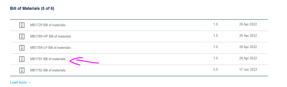

Sarra.S
Hello @KKan.1
Thank you for your input, the updated corrected BOM is on-line:
