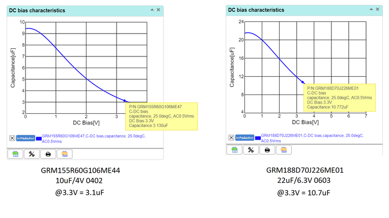

Is the capacitors required values taken into consideration the capacitance degradation Vs DC bias?
For example:
The SMPS input required is 4.7uF (10uF recommended)
Looking at the STM32H735G-DK (Evaluation board) bill of materials, C(in) of SMPS is a 10uF/4V in a 0402 case.
Under 3.3V, this capacitance drops to ~3uF. to achieve 10uF under 3.3V there in no choice but to use 0603 case size and at least 22uF of capacitance:
In other words, the evaluation board input capacitance does not meet the specs.

> Should I aim for the required capacitance at the operating DC voltage as mentioned?
That's what I would do, and in case of doubt - if the board space is available - place an extra cap.

1) OMG, that's bad design...
a) but it seems that these X7R / X5R from Murata are extra crappy - or was that drop < 50% cap typical for these ceramics?
b) in general, choosing caps with a voltage rating of 4 V for 3.3 V - especially at an SMPS input: bad idea
2) more caps -> lower ESR / ESL, and for sure I would rather use 2x 10u
2024-10-14 10:22 PM

There is not much capacitance you can squeeze from a 0402 case, maybe ~3.8uF @ 3.3V at best...
For example: p/n GRM155C80J106ME18 10uF/6.3V
And to think that when you buy an evaluation board, you get an electrical design that should represent the best performance of the component, or at least the optimal performance...
It's a board I wouldn't dare to test for EMI.
Anyway, how should I refer to the capacitance required on the specification sheet?
Thanks
Nir
2024-10-14 11:06 PM
