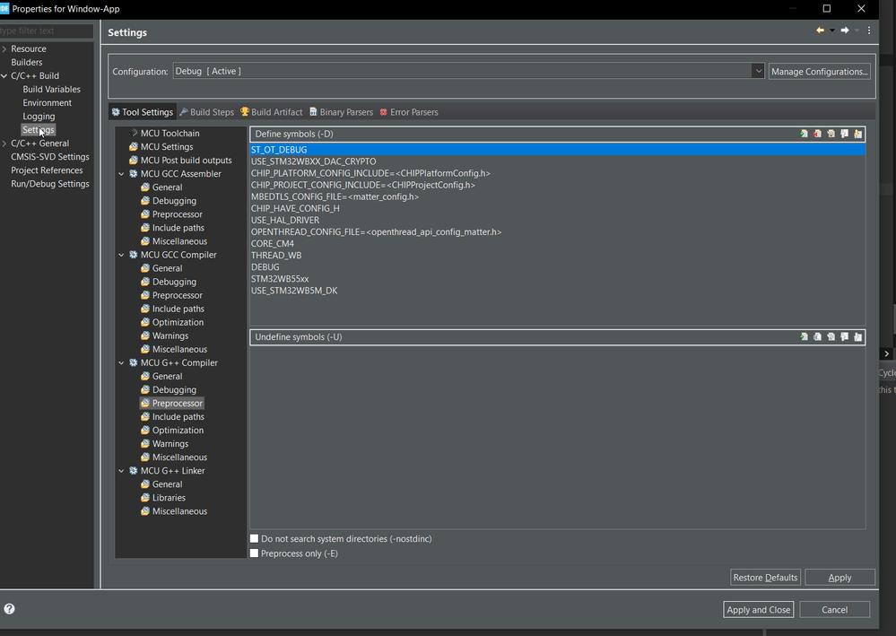

#endifAnd the USE_STM32WBXX_DAC_CRYPTO flag needs to be set inside project settings to properly propagate everywhere, like this (for both GCC compiler and G++ compiler options):
This way, it compiles ok on my side, I haven't actually tested the whole functionality.

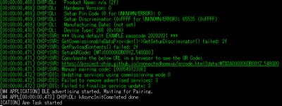

Also, I have changed some parts of the FactoryDataProvider.cpp as you provided previously, but it seems that Serial Number, Product Name, Setup Pin Code, etc. cannot be read and Advertising is not started.
Can you please help me to find the cause of this problem?
2024-08-14 11:14 PM
Sorry, I was able to read the data written in genFactoryData.py and start Advertising and commissioning. it seems that the reason is that I did not write IterationCount, Spake2pSalt and salt.
