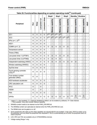

Is it possible to use the ADC polling/DMA/IT in STOP2 mode. The application is to develop a low power platform for ADC sampling and go back to sleep. After a certain period send this data over BLE.
2024-08-19 10:31 PM
Hello @ABN
As you can see on the table table 25 of the RM0434, the ADC can work only in RUN, SLEEP, Low Power run and Low Power Sleep modes:

2024-08-19 10:31 PM
Hello @ABN

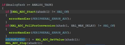

I went through the example. But I was not able to see the IOC configuration and the driver files. Instead of the approach given in the example, I used ADC Polling method
In this approach I'm getting HAL_ERROR in the HAL_ADC_PollForConversion
