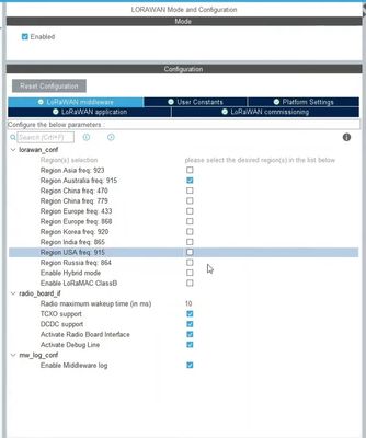

For now, cube Mx just give as this interface:
hope the next version will give as some more control.
