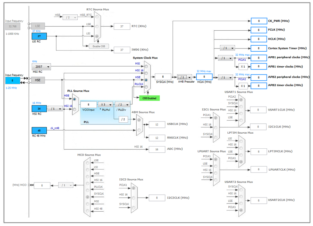

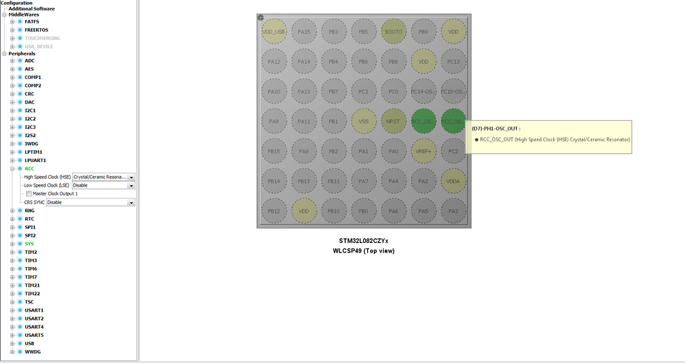

Ok, I saw that TXCO_OUT and VDD_TCXO was directly connected to OSC_IN and OSC_OUT, so I have to manage this part directly in my program with RCC management
Do you know if it's possible to delete properly this conection in order to use HSI instead TCXO as clock source?
Here a brief configuration of RCC:
Thank you.
2018-06-13 8:51 AM
Most of the examples use the MSI to clock the L0, the default usage of the TCXO is for the radio, where it matters. I'd imagine one reason to use it on the L0 is to reduce start time, and skip the PLL.
Might be hard to get 8 MHz HSE, would need to fiddle with board jumpers or solder-bridges on DISCO
