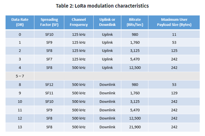

@Yuvi wrote:I fill a 242-byte buffer and try to transmit data it only transmits data at SF7 and SF8 and not at SF9,10,11,12. At this SF I'm getting empty packets
The over-the-air payload size is significantly smaller at the higher spreading factors - maybe the problem is in your splitting of that "large buffer" ... ?

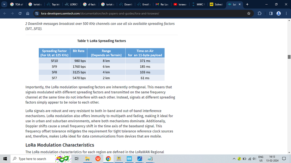

I got your point, and as this picture/google says we get SF7 till range of km. But as I go beyond 50 meters SF drops from 7 to 12. How can I get a better data rate with a range of 1 km?
