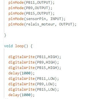

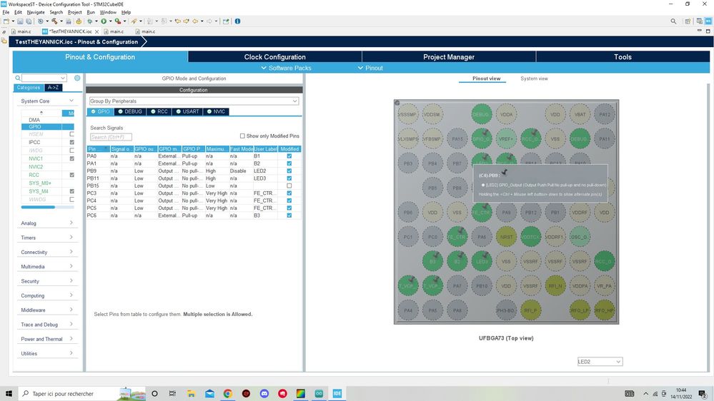

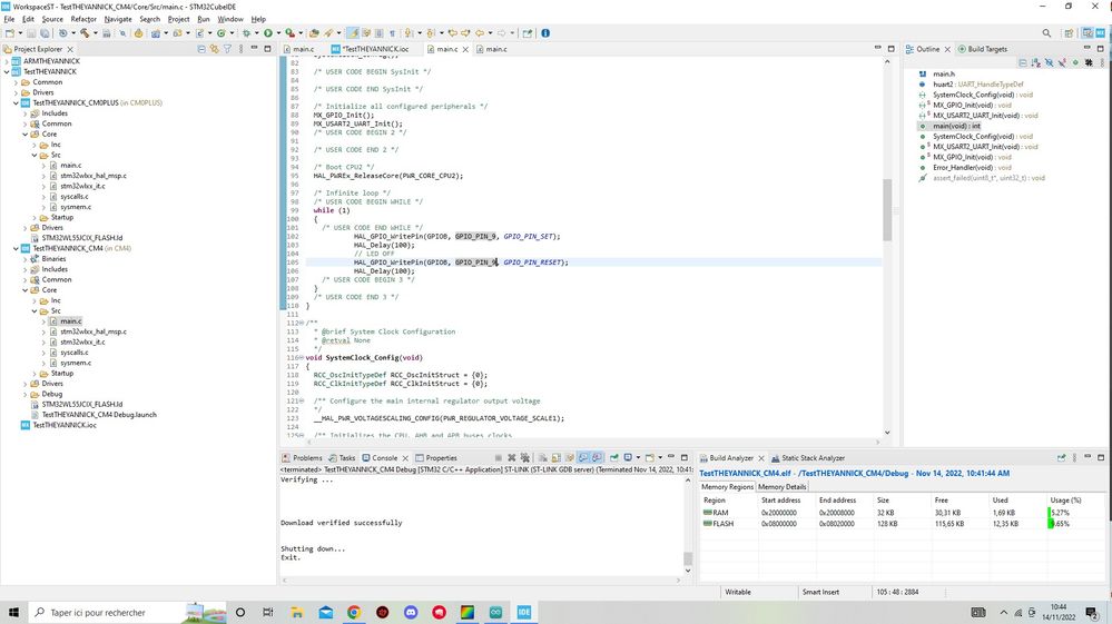

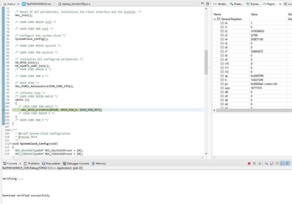

Hello, i just bought a STM32WL55JC2. It's working perfectly on Arduino but i want to use the LORA module and Arduino doesn't support it.
I've configured my stm on CubeMX and tried a basic HAL_GPIO_WritePin but it doesn't work and i can't figure why.
Arduino working code :
Thank you :)

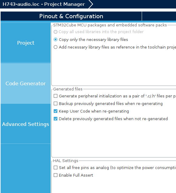

check: did you
x set free pins as analog ?

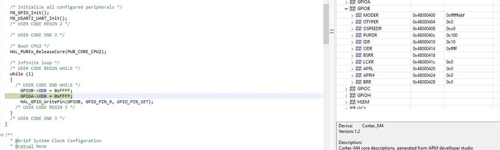

2022-11-14 4:37 AM
why only download ?
try : debug and you can see the port registers , when you step in your prog.
2022-11-14 6:02 AM
@AScha.3 I can't figure which register is attached to my LEDs ? Thank you
edit : r1 and r2 have changed for 512 after 1 while loop
2022-11-14 6:09 AM
The registers in the GPIOB peripheral, ie GPIO->ODR
And the clocking of the GPIOB via the RCC peripheral
2022-11-14 6:16 AM
Thank you, where do i check the GPIO->ODR state in the debug mode ?

2022-11-14 6:44 AM
there is a problem with the BSRR right ?
i tried to change manually the register ODR but it still doesn't work
2022-11-14 6:50 AM

2022-11-14 6:53 AM
BSRR is write only. so nothing to read!
and ODR shows ffff , what you write in. so whats wrong ??
2022-11-14 7:01 AM
if my gpiob->ODR shows ffff the led on my board should be turned on right ?
