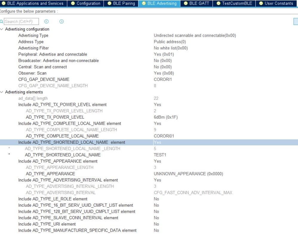

In the BLE Advertising tab, it seems to default to everything turned off. By turning bits on, it allows you run the code generation, and creates a variable "ad_data[]" int app_ble.c. This seems to replace the "manuf_data[]" variable used in the P2P server modes, but also used in the MOOC example on modify a BLE profile.
Unfortunately, trying to fill in the various entries on this tab cause the code generation to fail in a couple of different ways:
Looking at the other entries, it looks like the first value (which is valueNotSetted, and "Setted"? Really?) is actually the length of the entry plus 1, so it should be 5 in the CubeMX view, it does show "5" in the LENGTH field, but this doesn't make it into the code.
If you include AD_TYPE_ADVERTISING_INTERVAL, you can't change any of the settings (it is set to CFG_FAST_CONN_ADV_INTERVAL_MAX), the generation process seems to fail completely, although you don't get any outward error messages or feedback: In app_ble.c, 126 empty lines are empty, just after the file header, and the file ends with the following:

uint8_t ad_data[21] = {
2, AD_TYPE_TX_POWER_LEVEL, 0x1F /* 6dBm */, //Transmission Power
9, AD_TYPE_COMPLETE_LOCAL_NAME, 'C', 'O', 'R', 'O', 'R', 'I', '0', '1', //Complete name
3, AD_TYPE_APPEARANCE, 0x00, 0x00 /* UNKNOWN_APPEARANCE */,
3, AD_TYPE_ADVERTISING_INTERVAL, 0xA0, 0x
