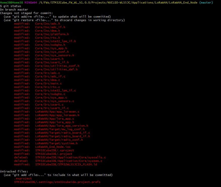

About lacking file to regenerating sample I've done some GIT based diff between original sample and generated one. Ok some delta as expected (because generated project is working) but according to me nothing is lacking ...
Only x2 deleted files (what you can recover) are helpers sysmem.c & syscall.c

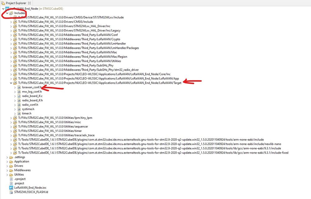

@SHATE.1 fact is you have such files but have to get a bit of habit of some STM32Cube structure (there's couple of depending of project setup ... and yes I'm sharing your pain ...).
Discussing about lorawan_conf.h as example here it is: you've to look at includes ...
Here in fact I assume you have all AN5406 is describing but maybe at another place ...
