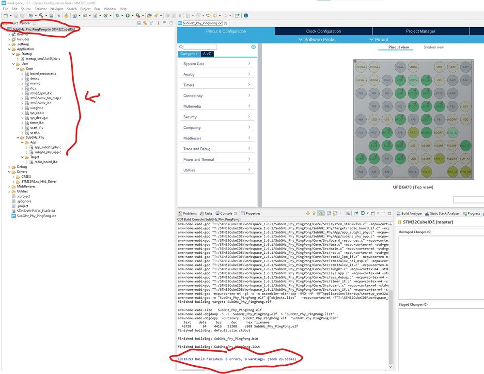

please find attached IOC file. My feeling is that the problem is related to fact that I have installed the CubeMX and CubeIDE under account with admin rights and now running them under different account with regular/limited user rights.
The project in my workspace was generated by File --> Import --> Import STM32Cube Example --> then selected SubGHz_Phy_PingPong. Compiles OK, but when I launch CubeMX (=doubleclick IOC in CubeIDE), change something and regenerate the code it compiles with many errors as explained. I have found out that under STM32CubeIDE\Application a new directory "User" is created, it is included in automatic makefile generation and spoils the compile. When I remove this directory everything surprisingly compiles as before, the HW changes I have made in CubeMX are also included. So in fact I have found the workaround, hope this helps.

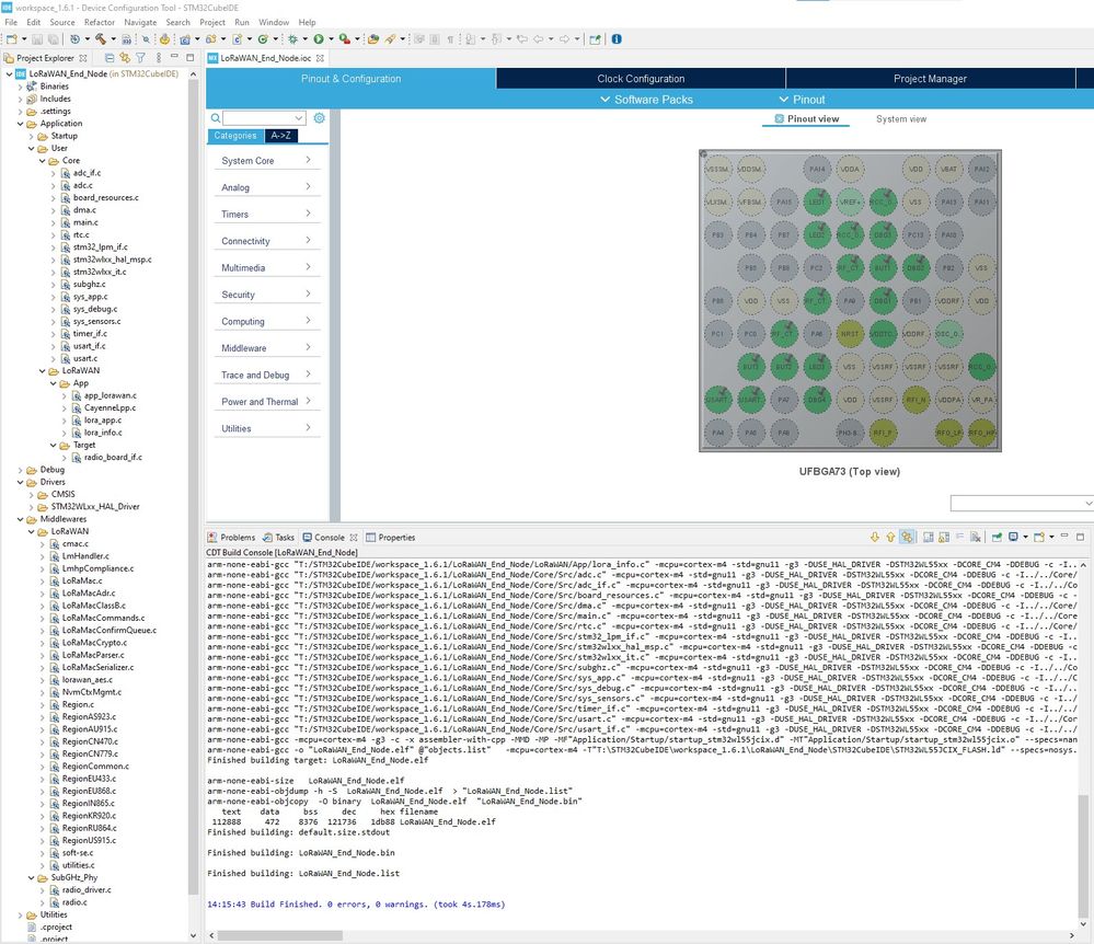

I'm an electronic engineer from ArcelorMittal and I have the same problem!!!
when i open the project LORAWAN end node from example and i compile, everything is well and i can build and programm it in my Nucleo board and i can connect to my gateway. But when i try to change something in CubeMX, transmission period or HW modification and i build again, i have 1124 errors!!!
i found too the file " user " in application folder and when i delete it and build i have 882 errors and the problem of compilation still here!!!

2021-06-04 10:17 AM
@SHATE.1 @_JUhri.1 I've been able to reproduce the same. Sounds like a shame about STM examples packaging but I've found proper way to recover.
1) From original STM example (takes care not corrupted already but your previous actions ... maybe best is to remove FW pack repository and unzip it back) let's import it.
2) Once done just remove Core & Target & App & User folders (in other words keep only Starup folder)
3) Open .ioc file (x2 click on)
4) Ask for code generation
=> Here you're. Your project is updated and compiles fine.
Then feel free to use it / improve it like you were expecting to do !

2021-06-07 5:13 AM
@SHATE.1 sorry but you're amending first a post initiated by @_JUhri.1 . Such post is about SubGHz_Phy_PingPong example ... so please do not complain then if you're mixing stuff. Best is to open your own topic ... helping community and increasing chance to you to get proper help.
Such said I've got too a look to LORAWAN end node example. Issue appears to be the same. Just import back a fresh LORAWAN end node example material then delete Core & Target & App & User & Drivers & Middlewares folders. Finally ask for code generation. Works then on my side then.
2021-06-07 6:47 AM
Thanks for your answer
Effectively, when i delete folders that you indicated ( Core & Target & App & User & Drivers & Middlewares folders) and i open .ioc and make a modification of HW or any other thing i have no errors when i compile!! thank you it look good but i have to test the behavior of my end node device when if it will be connected to the gateway.

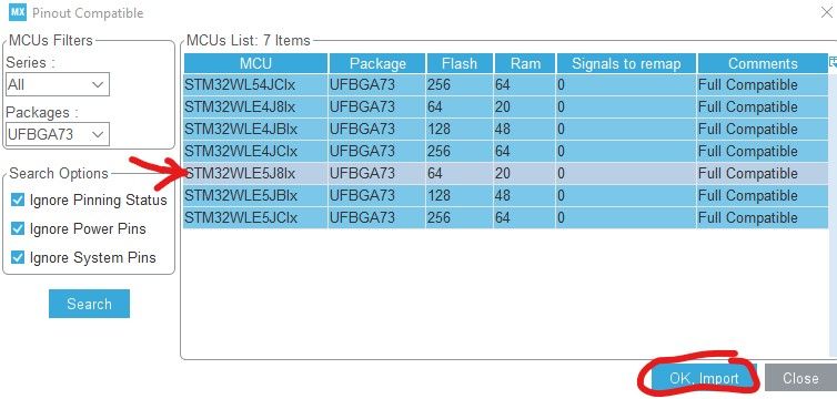

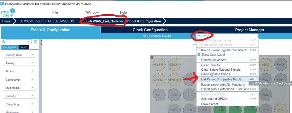

For the modification of the MCU of the nucleo to the STM32WLE5J8I, have you please an idea with conservation of the application?
Thank you

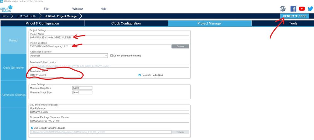

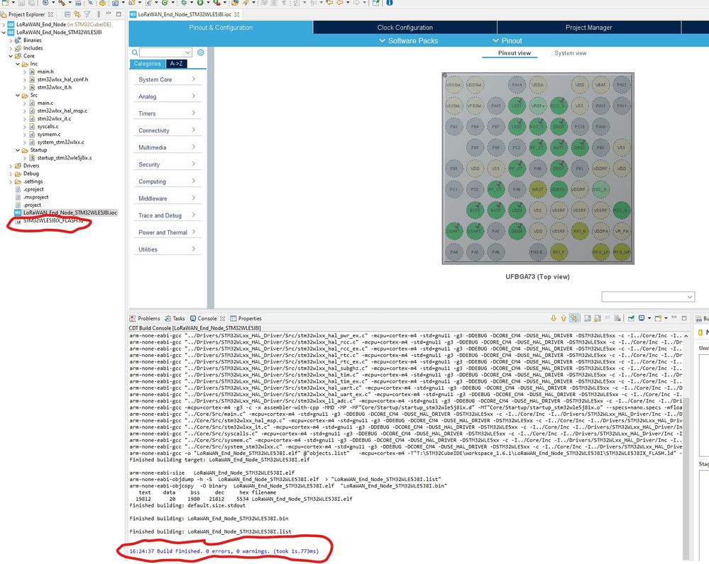

2021-06-07 7:27 AM
Myself updating device as sounds .ioc file project based generation is working quite well here I would relying on STM32CubeMX standalone application.
1) Run a 6.2.1 STM32CubeMX session
2) Load .ioc file which is part of such LORAWAN end node example
3) Move to your compatible target device
4) Add project name and location
5) Ask for code generation
6) Open such project within STM32CubeIDE
7) Works for me and compile success !
Despite sounds like a pain to leave IDE it works fine and takes me 2 minutes to conclude !
