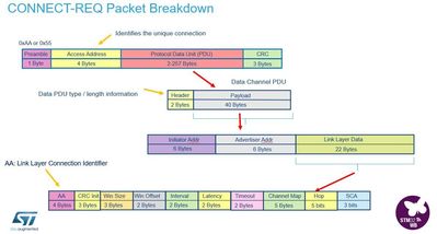

You can get your BD address when you receive a CONNECT_REQ packet.
See in attachment a description of this packet format:
You just have to analyze the received packed to extract your BD address depending on the role of your device: Initiator = Client or Advertiser = Server.
One the connection is accepted by the advertiser. The connection is identified by the  AccessAddress field that reflects the value of the AA (AccessAddress) field which is the first item of the Link Layer field of the PDU.
Best Regards.
