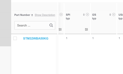

2024-11-14 9:11 AM
Understood and I upgraded to the STMWBA54.
Just to be clear, the data in the product selector is wrong and should be corrected at some point, but it's not a problem at this point {see below screen shot}.
Thank you for the information and quick response to my question.
