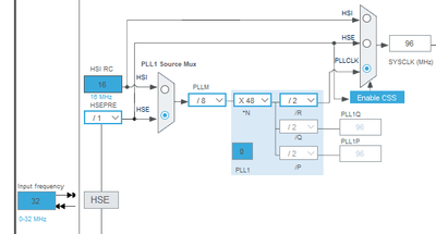

2024-11-14 6:16 AM
A simulation done on CubeMx:
2024-11-14 8:19 AM
Hello @BKaiwalya
Could you please update the function:
scm_setsystemclock(SCM_USER_APP, HSE_32MHZ);
to:
scm_setsystemclock(SCM_USER_APP, SYS_PLL);
After setting the PLL mode and parameters through (mendatory before calling the scm_setsystemclock) :
void scm_pll_setconfig(const scm_pll_config_t *p_pll_config);
With PLLM = 8, PLLN = 48 PLLR = 2 and PLLFractional = 0.
More details about those functions are available on the scm.c and scm.h files.
Best Regards.
STTwo-32
