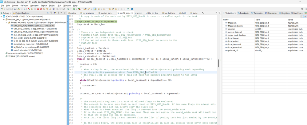

The bootloader binary has BLE stack initialized with generated code and also user app used BLE stack as well with different GAP profile.
The function APPE_SysUserEvtRx is not called after jump from bootloader to user app binary.

}The jump is successful if I do not use any commented out shci.h functions but BLE advertisement does not work then in user application binary.
If I use shci.h functions to stop BLE in hopes of stopping the stack to re-init later then that keeps sequencer waiting. Means stuck forever in bootloader.
