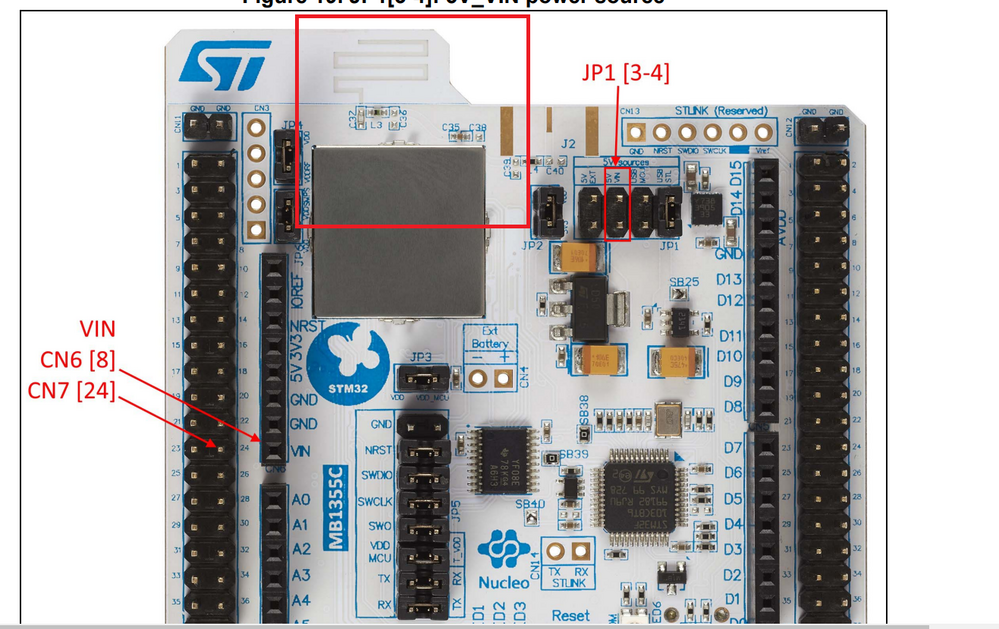

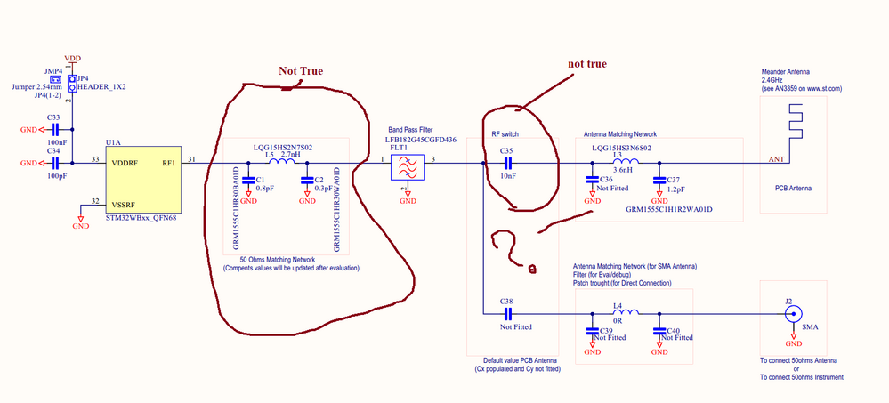

In the User Manual UM2435 for Nucleo STM32 provided the next schematic

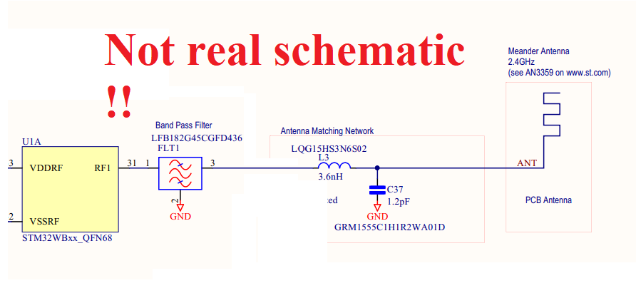

But in PCB we see the next
I think that the next schematic is actual, is it correct?

Hello @IRakh.1 ,
You can refer to P-NUCLEO-WB55 schematics boards shared in ST web site.
For that, if you have C02 board revision, you can refer to the MB1355-WB55RG-C02 Board schematic
and if you have D01 board you can refer to the MB1355-WB55RG-D01 Board schematic.
