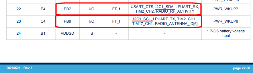

I'm developing a BLE device using the STM32WB05 that supports I2C and BLE connections.
I successfully established an I2C connection using I2C_SCL(PB6) and I2C_SDA(PB7).
However, PB7 is used for RADIO_RF_ACTIVITY on BLE, causing a conflict between BLE and I2C.

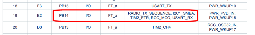

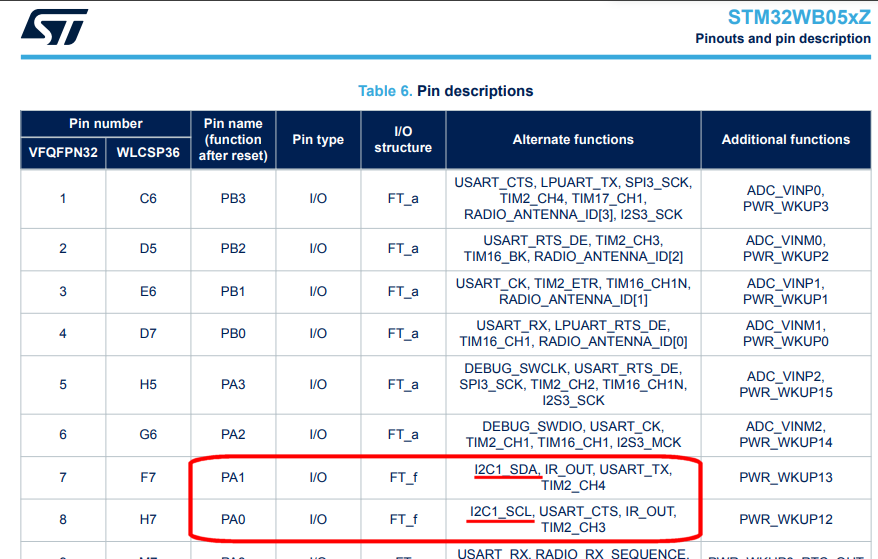

According to the table 6, table 7 and table 8 of the DS14591, I2C1_SDA and I2C_SCL are available on PA0, PB6 for I2C1_SDA and PA1, PB7 for I2C_SCL. The PB14 is used for I2C1_SMBA signal.

@nama wrote:I tried changing to I2C_SCL(PA0) and I2C_SDA(PB14) .
As @STTwo-32 said, There is no I2C_SDA on PB14:
You need PA0 and PA1:
