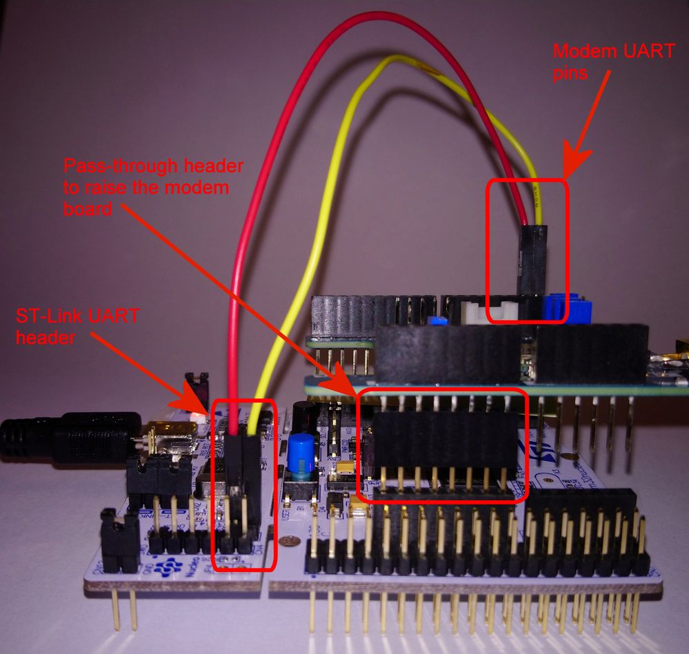

To talk to the USI shield, you will need to disconnect it from the Nucleo board, supply 3.3V power, and connect to its UART pins.
I did it like this (I call the USI shield "modem"):

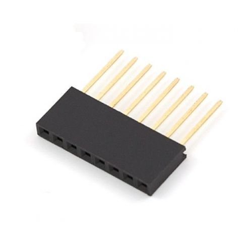

With a "pass-through" header like this:
so that gives power to the USI shield ("modem") from the Nucleo board, but isolates everything else.
then the jumper wires connect the USI UART to the Nucleo's virtual COM port.
And then you can talk to the USI shield.

2021-03-14 9:45 AM
WOW! Your connections shown in your photo work! Thank You! Andrew! :thumbs_up:
ST should add this photo to the manual. A simple step saves many users` time.
