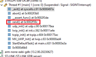

When i click play, the display works fine so the display task works fine I guess, but when i try to ping IP 192.168.1.50 I don't get response. When i click pause I find that the code is stuck in some sort of handler called _exit. I am providing a photo of debugging window.

It looks like a LWIP issue more than a TouchGFX issue.
Looking at your call stack, you got an assert from the rand function, can you check it, what could have caused the assert?
Can you check the address?

For the address to check, look for the "rand()" :
This is most likely called when you set the range in the screen shot you shared.
