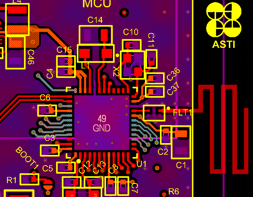

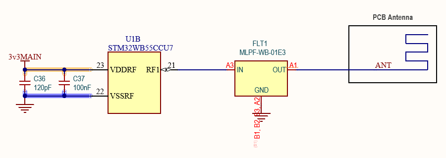

Dear Everyone,
I created a custom STM32WB55 board taking hardware consideration from the RF hardware guide. Instead of a discrete matching network that was used on the Nucleo, we used IPD (integrated passive device), which was pretty much the equivalent. Based on pg.32 of AN5165. The schematic and the actual PCB design are shown below. The custom MCU of the custom board was ok, I could load firmware, debug and code just fine, but when I tried the BLE, I could not even detect the device on the BLE toolbox. I tried the Beacon sample firmware still nothing can be seen.
Can someone help me with this issue, or has somebody encountered the same problem?
I’ve exhausted the net, scouring for a possible solution, but it is hard. That is why I’m asking for somebody’s expertise regarding this.

Just some more clarifications:
2023-01-08 6:32 PM
HI @Remi QUINTIN ,
Thanks for the response.
Any troubleshooting tips would really help me, I'm willing to share here the design file.

I see, thank you for your input sir @FWiew.1, However, in my case, the board that I had with me is straight from PCBway, so I'm assuming that they made it right on the assembly. But since I had a spare board, ill try to remove the matching filter. Anyways thank you very much. Seems I'm not the only person encountering this issue.
2023-01-17 12:52 AM
Update,
Hi @FWiew.1, I removed the MLPF-WB-01E3, hoping that this is the cause of the problem. And tried the YT tutorial you suggested. But it still didn't work on my End even though I'm as close as possible on my board.
Perhaps there are some parameters that need to tune. :(. @Remi QUINTIN any help will be much appreciated.
We plan to mass produce these board and use it on our weather system here in our country so any tips that will make this work will really help. I'm starting to have second thoughts about using other BLE modules. But still, I'm hoping that this is a matter of software issues.

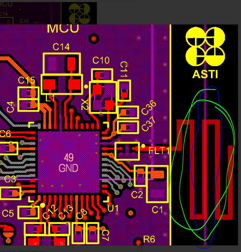

2023-01-17 12:57 AM
2023-01-17 1:12 AM
Indeed, one key point mentioned by Javier: Is the HSE crystal delivering the correct frequency = 32 MHz with max 50 ppm?
What crystal do you use? Did you trim it on your custom board?
