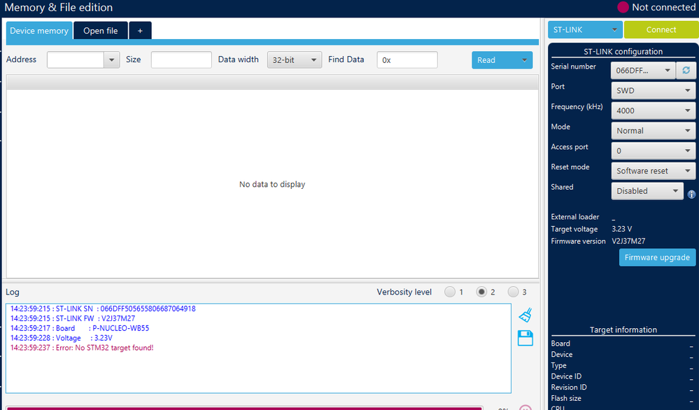

I have tried with STM32CubeProgrammer and it has the same situation, it is able to see the st-link configuration but unable to connect to the stm32wb chip showing "Error: No STM32 target found!"
