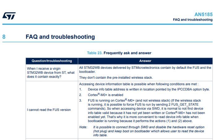

Hello @MPian.1 ,
To identify the FUS version, you need to read the shared table memory in SRAM2a. This is explained in the AN5185 in the section 1.6 Shared tables memory usage and in Section 6.1 Shared tables usage.
Hope that answers your question!

I have images with version STM32Cube_FW_WB_V1.13.2. I really would like to know the version on the board I received. Please recommand a tool to do the job and steps to get the job done.
Anyone can help?
Nancy
2022-04-27 8:49 AM
Issue is solved with STMCubeProgrammer tool (v2.10.0). See https://www.youtube.com/watch?v=1LvfBC_P6eg&t=314s at 3.25m.
