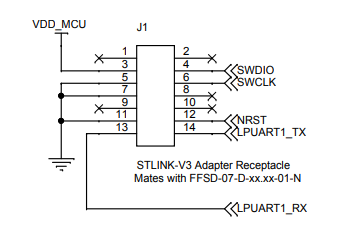

I'm new to working with STM32, and I'm having issues getting some kind of output to the console (have been using both Tera Term & the built-in console in STM32CubeIDE) when working with the Steval-Proteus1 board.
I tried following two seperate guides "How to redirect the printf function to a UART for debug messages" & "How to wake up the STM32U5 from STOP2 using LPUART". The boards are different from Steval-Proteus1 but I figured the principles would be the same and I just had to adjust the pin assignments.
In my latest attempt, I created a blank project in STM32CubeIDE with MCU: STM32WB5MMGH6TR. I set LPUART1 mode to asynchronous and assigned pins PC0 and PC1. Below is two screenshots of the schematic for Steval-Proteus1 with the first being the MCU on the board and the second being for the connector connecting to the ST-Link-V3.
_legacyfs_online_stmicro_images_0693W00000dJpyQQAS.pngHere is the code I used from the guide "How to redirect the printf function to a UART for debug messages". Note that in: HAL_UART_Transmit I use &hlpuart1 instead of huart2

Does anyone know why I don't see any output in my console? I hope you guys can help me.
