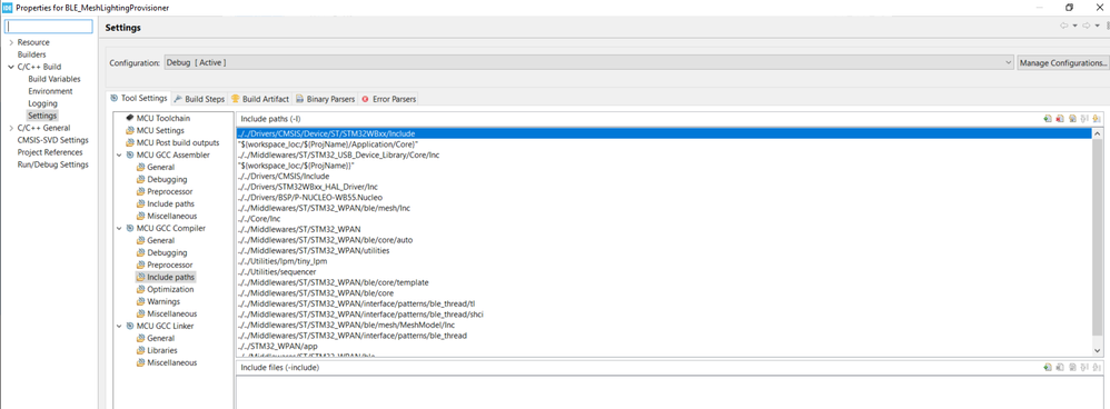

=======================build setting ==========================
=======================app_entry.c=========================
