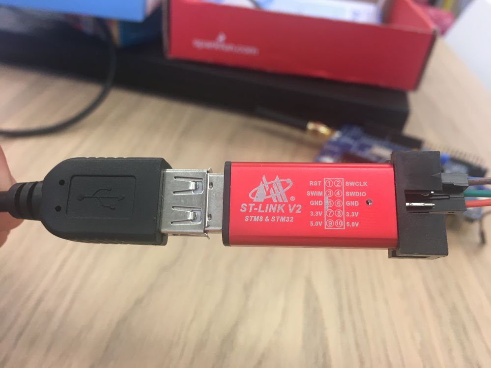

It seam I need to use this
but how to connect, and how to flash ? :smirking_face:
and it look to have an micro usb connectot with the text "USB STLINK". May it be integrated?
