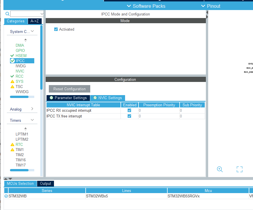

CubeMX 6.2.1 takes care of the IPCC functions that used to require being added buy hand:

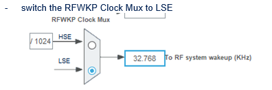

We also needed to make sure that we were using LSE for the RF system wakeup:
After making these changes, everything works as expected.
