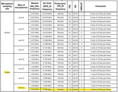

I also tried to implement the example that is written in the global manual (see the highlighted row of the table in attached image).
When I used 16 bits frame, 2 slots of 8 bits with sampling frequency 16 KHz and the clock signal to the SAI which minimize the sampling frequency error (= 0.05%), I expected to see on my oscilloscope SAI_CK = 1.024MHz but i see 128 KHz.
