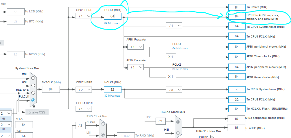

IF i were you i would (as you already did) increase the clock from the ADCs to the maximum (unless you start guetting some noise, then find a compromise between S/N)

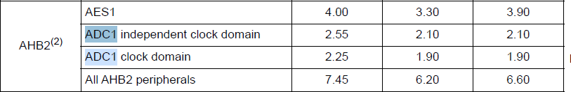

From the Datasheet DS11929
You could run the ADC clock up to 64Mhz
Then set your ADC conversion time to the fastest possible 2,5cycles at (64Mhz) conversion time is 39nanoseconds.
