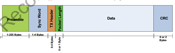

I am trying to get the NUCLEO-WL55JC radio backwards compatible with our previous radios protocol used in the SI4432 and the EFR32xx from silicon labs. Most of it is already working but I can not add a transmit header in the message. This transmit header are two extra control bytes placed between the sync-word and the length byte.
The transmit header is included in the CRC and data whitening, so I can not combine the transmit header with the sync word.
Is there any possibility to add these two bytes in the wireless message, I do not care if I have to manually check the transmit header and/or packet length. The main goal is to make this radio backwards compatible.
Some radio information:
- GFSK modulation
- 868 MHz base frequency
- 2 bytes sync-word
- 2 bytes transmit header
- 1 bytes packet length
- Variable packet length
- CRC16
- Using CRC over: Transmit header, Packet length and data.
- Using data whitening over: Transmit header, Packet length, data and CRC.

Hi @Bvan .9 ,
You can do that manually indeed.
You can find some useful material below, although not complying entirely with your packet format requirements:

Hi @YBOUV.1 ,
I've managed to do this manually and I can succesfully transmit messages, thank you for your help and information.
