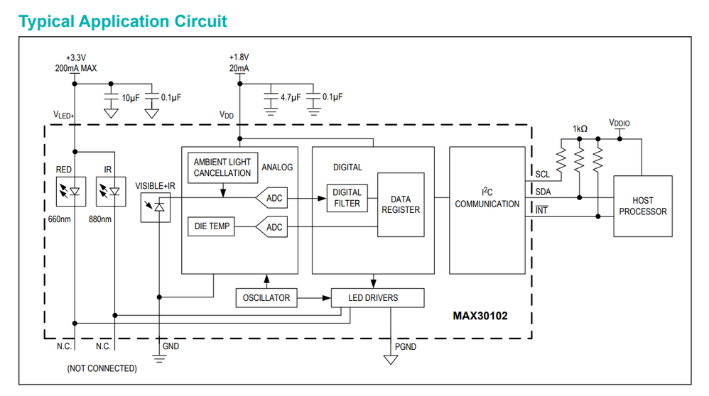

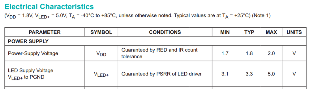

Hello @AJAY S ,
The MAX30102 operates on a single 1.8V power supply and a separate 3.3V power supply for the internal LEDs. (DATASHEET)
So, try to provide 1V8 as a power supply for the sensor MAX30102.

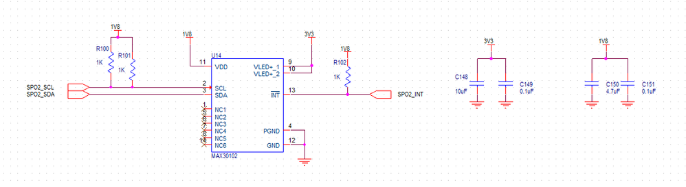

this is my shematic design sir here i2c i use 1v8 is that okey to communicate STM32WBMMG chip. in between 3v3 to 1v8 level shifter is required? or not thats my doubt
2023-01-23 2:40 AM
I think you are alright as recommended in the Datasheet of the sensor MAX30102 :
Foued
2023-01-23 2:42 AM
MY host is 3V3 sir,but my sensor is 1v8 thats why i had confussion.

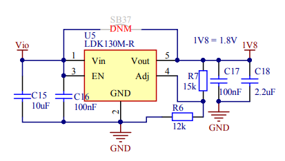

2023-01-23 2:50 AM
Try to use a regulator to provide 1V8 like the LDK130M-R.
I advice you take a look : Schematic diagram Motion MEMS and environmental sensor expansion board for STM32 Nucleo -

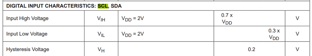

2023-01-23 4:40 AM
You can use it , because is in max ratings but need have this levels in range primary low under ...as you see High dont have defined up limit ... abs max ratings is 6V
