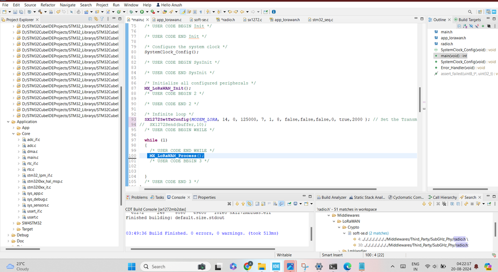

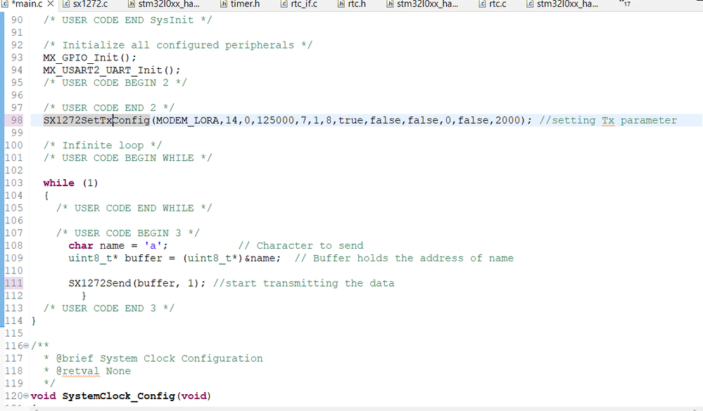

I am working on a point-to-point communication project using the P-Nucleo LRWAN2 board package. In this setup:
I have downloaded the LoRaWAN package for STM32Cube provided by ST, but I am facing difficulties using the library in STM32CubeIDE.
Here’s what I’ve done so far:
Could someone guide me on the correct way to integrate the LoRaWAN library with STM32CubeIDE? I’m not sure if I’m missing any specific configurations or additional steps to properly set up the project for point-to-point communication.
Thanks for your help!Inc and Src Folder
Console
main.c file
https://www.st.com/en/evaluation-tools/p-nucleo-lrwan2.html https://www.st.com/en/embedded-software/i-cube-lrwan.html#overview

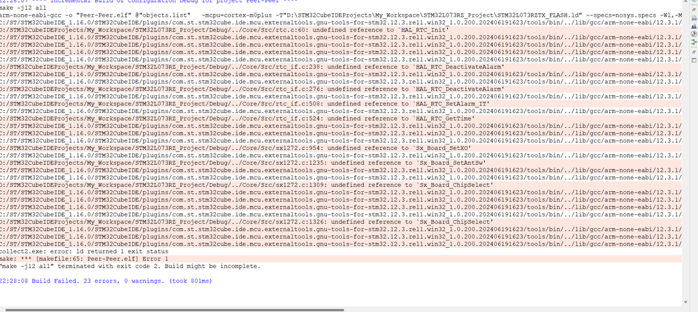

Thanks for the reply. You are correct, two NUCLEO-L073RZ boards can be used for communication. I will eventually use the NUCLEO-F746ZG as the gateway.
Could you please suggest how to set up the lora network using P-NUCLEO-LRWAN2 package where Nucleo-F746ZGT6 would be the gateway and NUCLEO-FL073Z as local node for LoRa communication? Additionally, I’m encountering undefined reference errors. I have included the necessary .c and .h files, but the issue persists. Any advice on resolving this

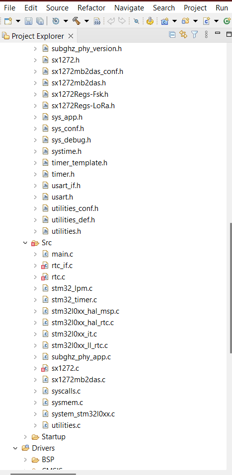

Hello
Thanks for your help, I am configuring the wrong files previously due to that I encountered error in .c and .f file. One thing I have to ask more, I am configuring NUCLEO-L073RZ board as end node using end node project in the lora package. In the main.c file there is a default function "MX_LoRaWAN_Process()" how to implement this function.
