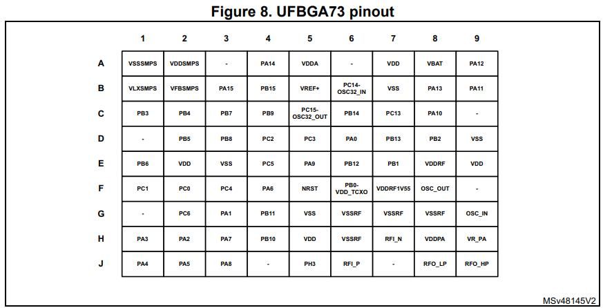

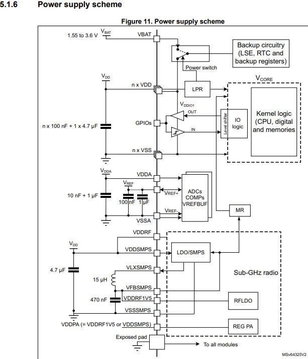

The power supply diagram shows the vssa pin of the chip, but it is not specified in the Pinout. It is also not clear the vddpa designation(= VDDRF1V5 or VDDSMPS) and why it is not connected anywhere. I also didn't find any information about vssrf. do you have a recommended connection scheme?
VSSA is the analog ground. It is the return path for VDDA. Connect to ground.
VDDPA is the power for the power amplifier. Connect to VDD. See "Figure 6. High output power PA" in the reference manual.
VSSRF is the return path for VDDRF. Connect to ground.
