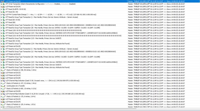

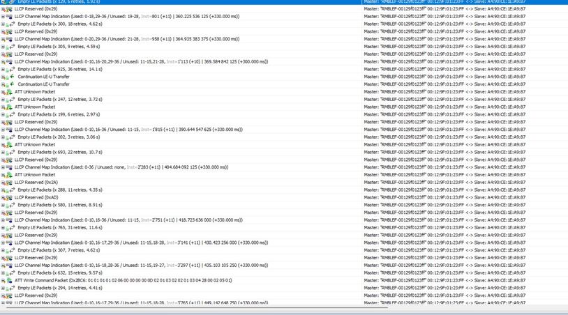

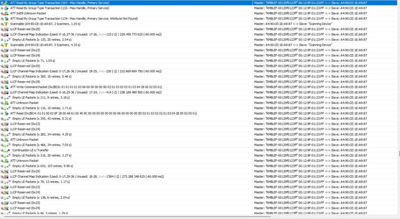

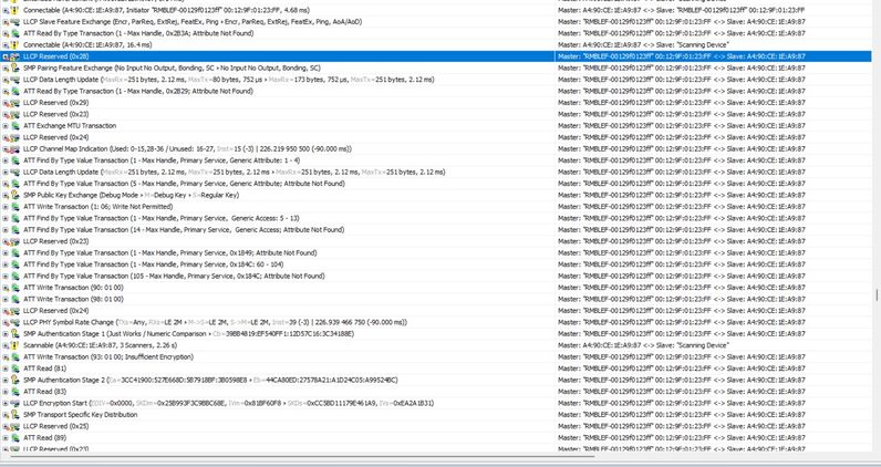

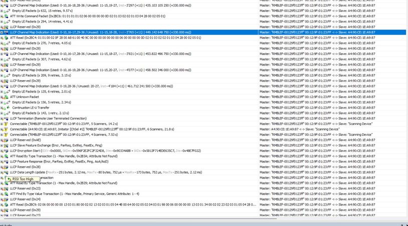

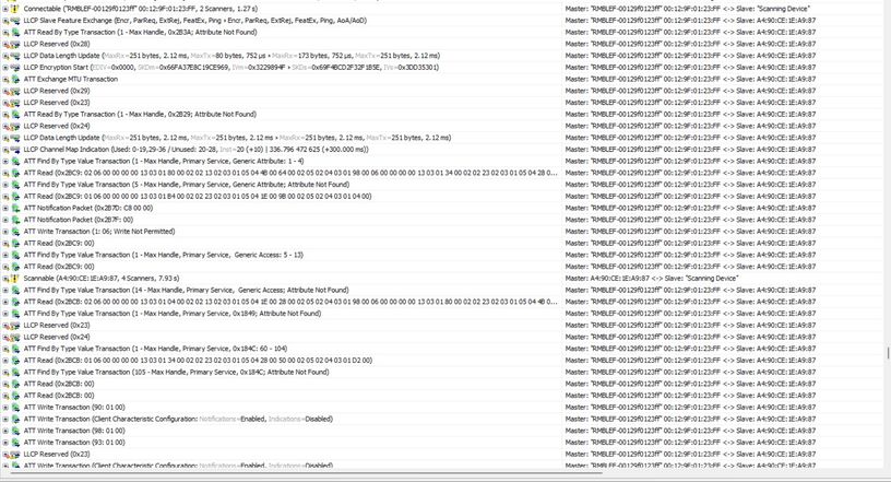

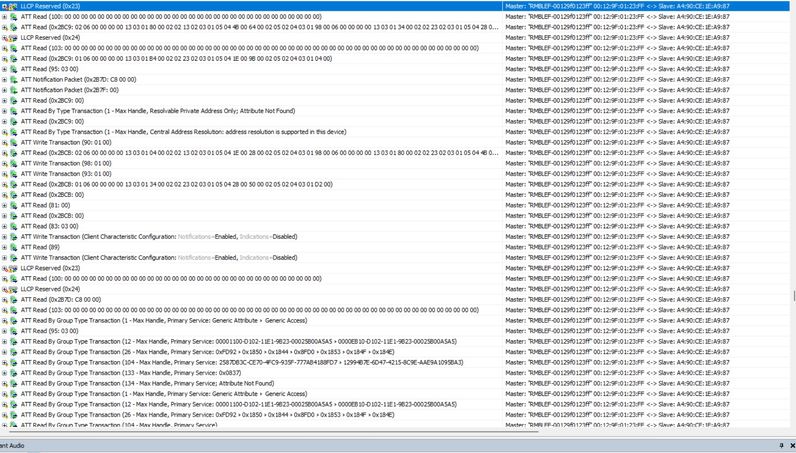

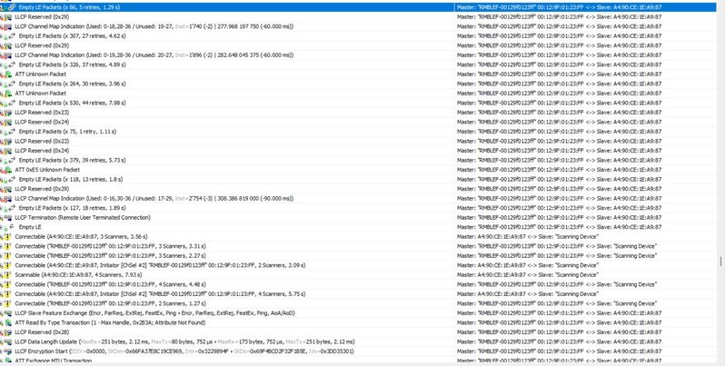

I've captured the air trace:
The first pairing:
The second:
2025-11-26 4:57 PM

Hello Huang Fan,
Thank you for the capture,
According to the air sniff traces, we can observe that the issue is due to a dealignments between the GATT databases of the two devices.
The first dealignment is related to the config descriptor of the GATT characteristics of the Audio services. The HAP Central has kept in memory that 'notification' is enabled for the Audio ATT characteristics from the first CAP linkup, but it is not done at the peripheral side. Consequently, when the HAP Central, during the streaming start procedure of the second connection, expects to receive a notification from the peripheral after a ASE Control operation, it never receives a feedback from the peripheral.
The Core specification says "The Client Characteristic Configuration descriptor value shall be persistent across
connections for bonded devices." (Core Spec - Vol 3 Part G 3.3.3.3), so the peripheral does not have the correct behavior.
The second dealignment is related to the initial state of the Audio Stream Endpoint when the HAP Central starts the Stream Audio Start procedure : The HAP Central restores the ASE State during the CAP Linkup restoration in CODEC CONFIGURED State while the ASEs in Peripheral side are in IDLE State.
Consequently, when the Audio Stream Start Procedure, the HAP Central performs a QoS Config operation with the ASEs but this operation is not permitted with ASE in IDLE State.
The change/reset of peripheral ASEs to Idle state should have been notified to the Central as well.
It seems the peripheral does not store any data related to CAP linkup. Ensure your device has the last software version since VIVO may propose some updates.
Note the proposed workaround to use CAP_Linkup() with CompleteLinkMode will bypass this peripheral issue.
