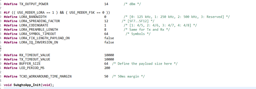

These are my LoRa RX settings. I'm receiving in RxBoosted mode.

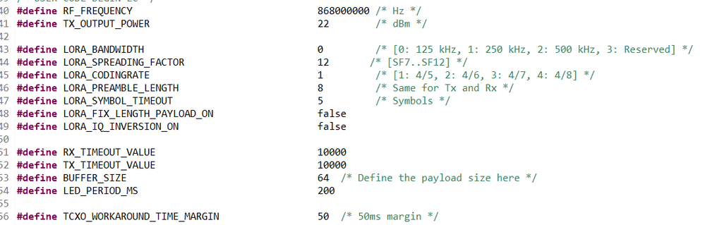

These are the TX-settings.

Transmit time is going to be long. Really need continuous reception as timeout doesn't realign with preamble, it's just relative to when you start listening and that can be totally out of synchronization with the transmission.
